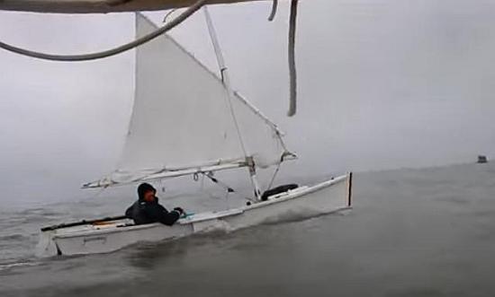

Chuck Pierce sailing his Mayfly14 on windy two reef day in very lumpy water of the Texas200 a while back. This a screen shot from Pehr Jansson's Youtube video titled "Chuck Pierce Crossing Aransas Bay In Mayfly14". Great clip and I want to point out Chuck's (very very experienced) rigging of his lug sail. Looks like he is using a drop down hoop over the halyard to keep the yard close to the mast. Then another loop where yard crosses mast. You will need these to keep everything from swinging wildly in big waves. But he also looks to have two vangs on the yard, one forward and one aft, to keep everything tight and solid and under control and to minimize sail twist. Great job!

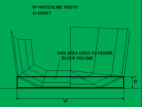

As I said before, some shapes are faster than others. For big ships, where the studies originated, it was found that a rough measure of shape could be the "block coefficient". Figures 1 and 2 show the idea behind the block coefficient.
block coefficient
block area

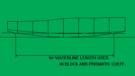

Here is how it's done. Let's say your boat has a waterline length of L, a maximum waterline beam of W and draft of D. Then you might imagine it fitting neatly into a rectangular block with length L, waterline width W and depth D. That block will have a volume of LxWxD. The block coefficient is calculated by dividing the actual volume of your below-the-water hull by the volume of the imaginary rectangular block.
So there are two parts to the puzzle here. The underwater hull volume is determined by the weight of the boat. Once you've defined the underwater hull the L,W, and D, you need to measure the block are easily found.

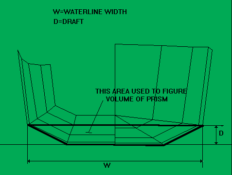

This is a refinement of the block coefficient. Imagine you have a V or round sectioned hull, or any section which deviates from a rectangular cross section common on big ships. Then you use the "Prismatic Coefficient". Figure 3 shows how that one is figured.
prismatic coefficient
Essentially the prismatic coefficient is figured the same way as the block coefficient except the rectangular block that you figured in the block coefficient is replaced by a similar constant section prism which has the same length as the boat's waterline and a cross section identical to the actual boat cross section.
You can see that the prismatic coefficient sort of takes away the cross sectional element that might confuse the block coefficient calculation. For example you might have two boats with a block coefficient of .5, one with very fine ends and a square cross section, and another with totally square off ends and a V bottom. But if the two were figured using the prismatic coefficient, the first boat would still have a prismatic coefficient of .5 and the second would have a prismatic coefficient of 1!
