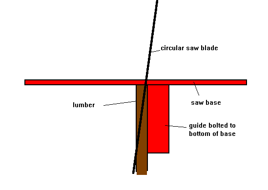

Actually scarf joints are easy except for cutting the scarf angle. There are fixtures made for circular saws that cut a scarf automatically like this:
Pro builders use these to cut scarfs on plywood, but the plywood has to be thin. The usual circular saw protrudes about 3" maximum below the guide, so if you are scarfing at an 8:1 ratio, the thickest wood you can cut this way is 3/8". Still, for a pro scarfing plywood it is very useful. But useless for scarfing 3/4" lumber.

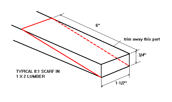

Let's say you need to join 3/4" x 1-1/2" lumber to make wales or chine logs for your boat. An 8:1 scarf in 3/4" thick lumber will be 6" long, like this:

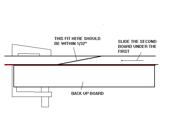

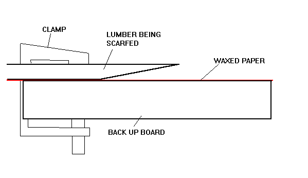

It's easy to draw the cut on the end of your sticks. You can try cutting it with a really good handsaw. It pays to practice. I've been able to cut the stick with a really good saber saw or circular saw but the guide has to be set exactly at 90 degrees and you can't waver in your cut. If you get a bad cut, you can try again on the same end. In fact if pays here to start with extra lengths of lumber so you can try several cuts on each board until you get the knack. You can also try working the cut to shape with a plane or rasp. If you have a power plane, you might try whacking the scarf to shape with only that. When you think you have two good ends cut, clamp one against a firm surface such as a length of 2x4, like this:
Slide the mating piece into position and check the fit. Remember that as you glue these up they must be straight. I think they should fit within about 1/32" to make a good glue joint with thickened epoxy. Like this:

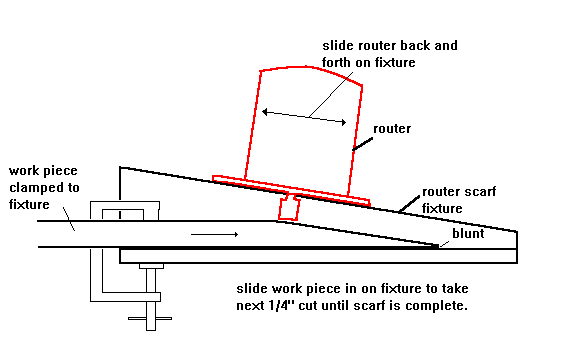

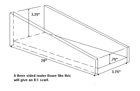

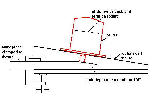

When I built a Birdwatcher a while back I needed to join a lot of lumber since the boat was 24' long and the mast longer. I built a simple fixture for my router for cutting the scarfs. It looks like this:
The base plate of the router needs to be removed (three screws) and replaced with a one wide enough to span the fixture opening in all positions. The fixture needed to be wide enough to scarf the 3" wide boards I was using for the mast.
Here is how I make a scarf cut with this fixture. The board is clamped into the fixture such that the router will cut no more than about 1/4" deep. The router is turned on and worked around the fixture until it has cut all the available material. Like this:
Then the board is unclamped and slid forward into the fixture such that once more the router will slice off another 1/4" of material, only this time there will be a lot more wood to cut. And so forth until the the entire scarf is cut. Or is it? I've found it best to avoid a total feather edge at the end of the scarf cut - leaving about 1/32" uncut seems ot work best, like this:

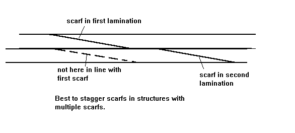

Once your glue is completely cured the joint should be as strong as the basic wood and you can go on building as if there were no joint there. But it doesn't hurt to be prudent. I try to locate the scarfs in wales and chine logs where the curvature will be the least. I try to locate the scarfs in masts towards the top, where the bending loads are the least. And on elements that have several boards with scarfs, such as wales with multiple laminations and boxed masts, I stagger the scarfs such that they are not all one atop the other.
