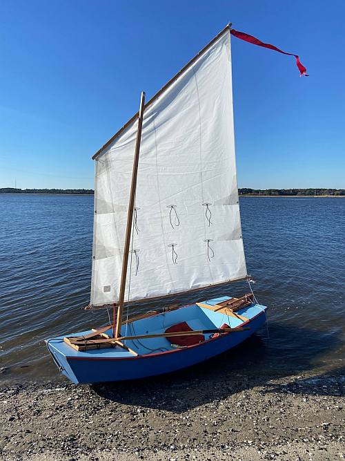

A closer look at Sean McCambride's Piccup Pram.
