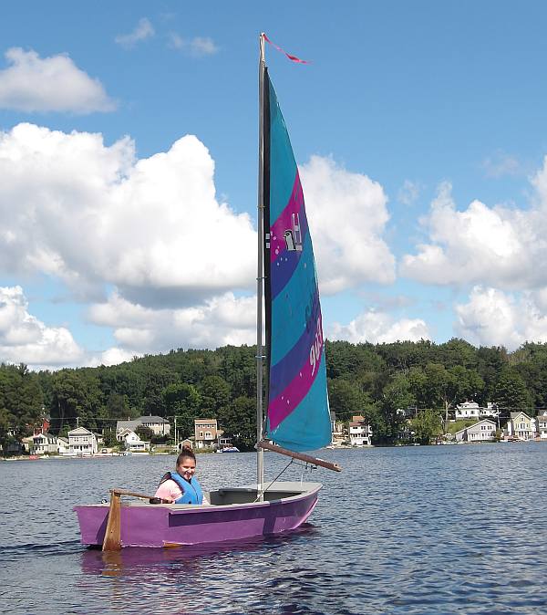

Ed Vaitones and daughter built this nice Piccup Squared in the best way - with materials you already have hanging around. He writes, "We built it to plan, except for some of the sailing pieces. We had some leftovers from an old pram, so used the mast and rudder from that. The leeboard is cut down from the Carnell boat. The bevels were a bit inconsistent, but PL filled the gaps. The plywood, some having sat under a porch for months, had some quirks in how it wanted to bend. On the positive side, we actually got the leeboard guard just right with the bevel and the curve. "
