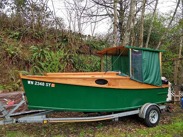

Ken Preston has his AF4B done and topped the cockpit with a hard top with fitted screens/windows/curtains. Beautiful job.

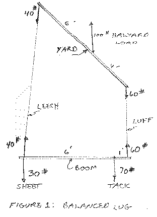

Figure 1 shows an idealized version of the spars of a balanced lug rig. Here I've assumed that all of the halyard load is transmitted through the luff and leach of the sail. That's not totally true but in a well cut sail only the luff and leach will be tight if the wind isn't blowing because the sail is cut to have a loose pocket of draft in its center. But when the wind starts blowing the entire sail developes tension and the yard and boom are loaded by that cloth along their length. Anyway, I've shown the halyard with a nice round 100 pound load. What are the deflections of the yard and boom?

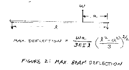

Figure 2 shows how to figure the deflection of a beam loaded as in Figure 1. The source of the equation is a book called Roark's Formulas For Stress and Strain. That book is a super cookbook for the stress analyst, the stressman's bible.
I think most of the elements of the formula are plain except for the "EI". E in an equation that predicts deflection is alway the modulus of elasticity, pretty much a spring rate for the material and it has units of "pounds per square inch" and has nothing to do with the strength of the material, only its stiffness.. It's a very large number. For aluminum E is 10 million. For wood E is about 1.5 to 2 million The length dimension "a" is always from the load "W" to the nearest end of the beam.

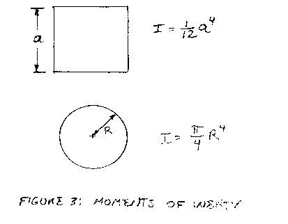

The "I" in the equation is the moment of inertia of the cross section of the spar. It has units of "inches to the fourth". Figure 3 shows how to figure the moment of inertia for square cross sections and round cross sections. As you see the I of both the square and round sections are related to the fourth power of the thickness of the section so a little increase in thickness gives a big increase in moment of inertia and thus in stiffness. For example a 1" diameter boom has an I of .05. A 1.5" diameter boom will have an I of .24. And we have increased the bending stiffness by a factor of 5! By the way, if you have a hollow spar, the I can be figured simply by taking the I of the OD of the tube and subtracting the I of the ID of the tube. For example, a round tube of 1.5" OD and 1" ID would have an I of .24 - .05 = .19. So the tube is almost 4 times as stiff as the 1" solid spar but only 26% heavier. So tubes are popular with those who can afford them.
Now, if you crank through all the equations for the yard assuming the yard is of wood and has a cross section of 1-1/2" square you will find the yard will flex over 3" under the 100 pound halyard load. (Actually the work was done with an applied load W = 70 pounds because the yard is tilted 45 degrees and only a 70 pound component of the 100 pounds is acting perpendicular to the beam.) So what?? It's actually a big deal to the sail maker. If you recall the essay on sailcloth you might remember that a sail 10' wide with a 1' draft will actually have an arc length of about 10' 2-1/2" across its middle. So the sailmaker will sew in the extra 2-1/2" to supply the draft. That might appear as a bulge of 1-1/4" along both the foot and head of the sail. So if the yard and boom are straight, the proper amount of draft will appear in the center of the sail. But if the yard flexes 3" under the sail load, it will pull all the draft out of the sail! So one of the problems the sailmaker has to face is to guess at the flexing of the rig. In this case he might supply the head with 3" + 1-1/4" = 4-1/4" of curve at the head of the sail.
But then again he may not supply that much and here is why. One nice thing about a lug rig with a flexing yard is that as shown above the flexing will pull draft out of the sail when a large sail load is applied. In many cases that might be considered to be good because it will flatten the sail in high winds. On the other hand, if you feel your lug sail does not have enough draft in high winds, one thing you could try to cure the situation might be to increase the size of the yard.
If you run the numbers for the boom, assuming the same 1-1/2" square section, you will find the flexing is small compared to that of the yard, about 1/2". That's mostly because the boom is shorter and because it is supported closer to its ends, near where the loads are being introduced. In fact it is possible that the boom will flex towards the sail under a large load and add draft to the sail in high winds.

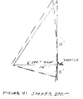

Figure 4 shows a free standing sharpie sprit rig. The sail of a sharpie sprit can be pretensioned by tightening up the snotter which is the tackle on the mast end of the sprit boom. How much will the mast flex?
Let's say the mast here has a 2" square cross section. And let's say the snotter tackle is a 2 to 1 thing so that the skipper pulls on the rope with a 50 pound tug and it results in a 100 pound preload on the sprit boom. The boom is in compression. You can imagine the mast deflecting under the load like a bow and arrow. Crank through the equations and it turns out the mast will flex over 3", assuming the mast is 2" square from top to bottom.
But few masts are made that way. Almost all are tapered and the taper greatly affects the deflection. As above, the sailmaker needs to know the deflection so he can allow extra material in the form of a bulge on the luff that anticipates the flex of the mast. Jim Grant of Sailrite kits recommended that the sailmaker predict the flex allowance of an unstayed mast by placing the mast on sawhorses and place a weight equal in pounds to 1/3 the sail area in square feet at the center of the mast. Then you stretch a line along the mast and measure to it a various stations along the mast and make a plot of the mast flex. Then that flex is added to the draft allowance of the sail at the luff. Usually the flex allowance is a lot more than the draft allowance!
