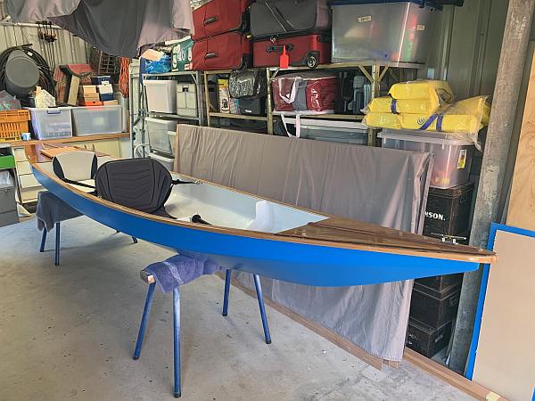

And Neil Shipley's Larsboat again all decked out and ready to launch.
