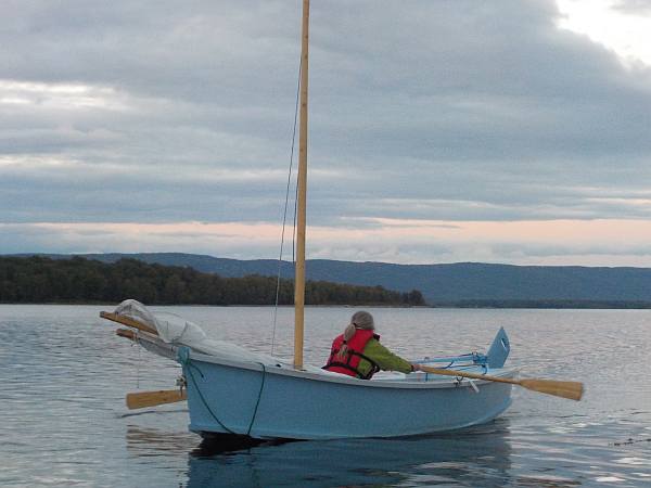

Jamie Sauder rows his Mayfly14 home in Canada.
