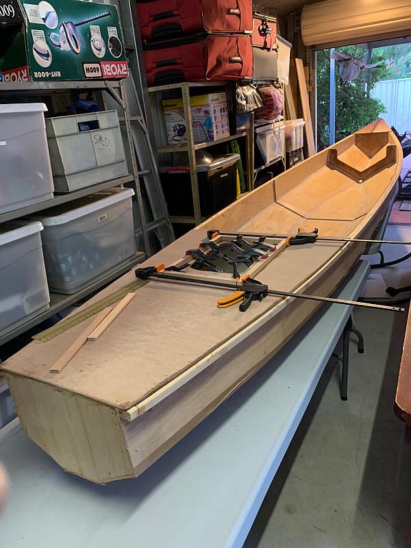

Neil Shipley's Larsboat in the last stages of construction. Looks about ready to paint.
