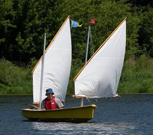

Wojtech Baginski, near Warsaw Poland, sailing his Robote sail conversion on the Vistula River on a windy day. One thing for me to note is that by my experience a reefed lugsail must have a way of keeping the yard close to the mast, otherwise it may swing wildly in rough water. Also it tends to get pulled aft and change helm not to mention allowing sail twist. In short you may lose control of it. My old essay on lugsail rigging covers this problem a bit. My favorite fix was a simple hoop of pvc pipe that is just dropped down over the mast head to seek its own level by gravity. It will ride up and down easily as the halyard is adjusted, yet it tends to find its way to the yard and stay there in normal use where it keeps the halyard close to the mast to stop excessive swinging. I did not invent it. I saw one done that way in a British magazine.
