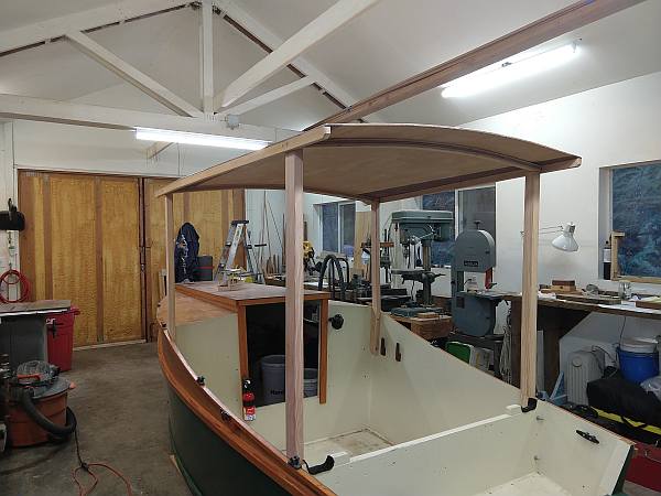

Ken Preston has added a hard roof to his AF4 to test. Concerns might be stability afloat, windage in a storm or on the highway (same as with a soft top), and let's add can you get it on a trailer and through the garage door. (My AF4 on trailer won't clear the garage door with the soft top up.)
