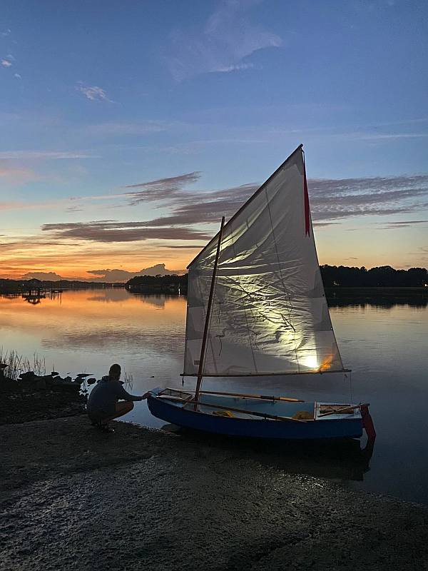

I don't know if Sean McCambridge is a pro photographer or not but he sent a series of great pictures that I will run in the coming weeks. He writes, "Greetings from Charleston, SC. I hope you�re well. I found a gently used Piccup Pram last week and have been sailing as much as I can. I just wanted to write and say what a great little boat this is. So convenient to load it up into the truck and drive away! I�m having a blast." More to come.
