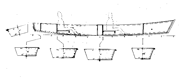

I drew it up in detail getting this:

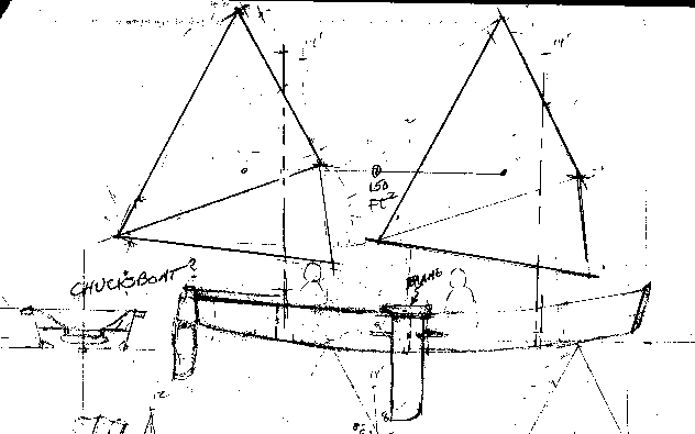

The sail rig was to be a split rig with identical lugsails fore and aft with the option to sail with just one of the sails mounted in the center, like this:
I think the single sail option would be preferred if sailing solo since that fore mast is way up yonder and one may not be able to handle it and the tiller at one time.

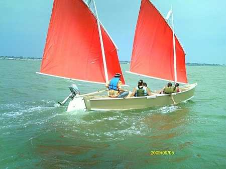

The prototype was quickly built by Gordo Barcom in Texas and here he is blasting along with family and polytarp sails straining. It was clearly a fast roomy boat:

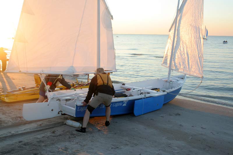

Then another, the Blue Laguna, was built and run in the 2010 Everglades Challange, 300 miles from Tampa to Key Largo, by Andrew Linn and Michael Monies. This boat had very little testing time as far as I know before the race. But they finished in 5 days and a bit but I think they slept in motels for two of the nights while the "press on regardless" guys were daring the night waters. Here they are launching off the beach (a requirement for this race):
And then pushing off in shallow water (there is a Sea Pearl behind them for comparison):

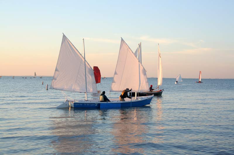

Finally a really nice photo of them approaching one of the three checkpoints in the race:
