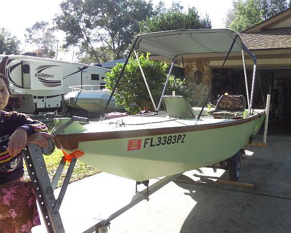

And what is this?? A very rare Alansboat by Richard Wright. He writes, " I've attached a few pictures of Alans Boat. As you can see I put a long shaft mud motor (a dragon tail) on her. That was great for shallow water (like 3 inches) but difficult to maneuver. The boat was easy to build and performed very well with that 6.5 h.p. Predator motor. It would almost plane with two people and would plane easily with only one aboard. "
