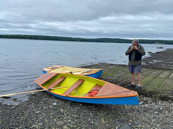

Another Sean McCambridge photo, this time with his Robote in front of the Piccup.
