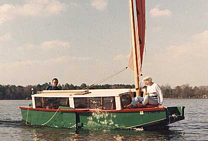

Wojtech Baginski again, Robote sail conversion on the Vistula River. Another detail of note here is the tiller rig. This happens a lot with ketch rigs where the aft mast is just forward of the rudder and prevents a long effective tiller. That also has the effect of making sure the weight of the skipper is well aft, which is seldom good. Anyway, what he has done here is to use a short tiller that goes to the side like a lever, and that lever is controled by a push/pull stick running forward to the cockpit. The tiller length is still short but the crew weight can go anywhere which is quite improtant in something like Robote. Another approach that Kilburn Adams used on his Sea Pearl ketch was to tie a line to the stock fore and aft tiller (which was still blocked by the mizzen mast), and that line sideways to a block, then forward to another block, the across to the other side of the boat, then aft again to a block and then back to the tiller handle. So it was big loop around the entire boat center. Anyone could steer from anywhere in the boat by grabbing the line and yanking either way. Worked great!

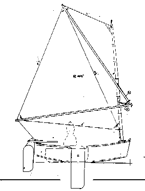

I've covered sizing and placing of leeboards in previous issues that you can find down in the Way Back Issues link. But to recap, the things you might remember are that the immersed area of the board should be about 4% of the sail area, and that the leeboard must be mounted at the hull's widest beam in order to be in flow parallel to the boat's motion. The suggestion on area would apply to any board such as a centerboard or a daggerboard (but those boards need not be limited to mounting at the boat's widest beam). Lastly, the sail area has to be aligned with its sail area center right above the center of the board's area, more or less.
Here is an example of a leeboard on Slam Dink.
slamdink
Notice that it pivots around a bolt which is placed to allow the board to retract fully above the bottom of the hull. You can't tell from the drawing but the pivot bolt runs through a lower hull guard and the top of the leeboard runs in a slot in an upper hull guard. The board is thus braced to take loads in both directions, unlike a tradional loose leeboard. As a result only one of these pivoting leeboards is needed on the boat, it works on both tacks, where the tradional loose leeboard only works on the lee tack so two are required. In truth these pivoting leeboards aren't really leeboards but are more like centerboards mounted outside the hull. While sailing you handle it just like a centerboard - just leave it down almost all the time except maybe while running and broad reaching. But I'm still going to call it a leeboard.

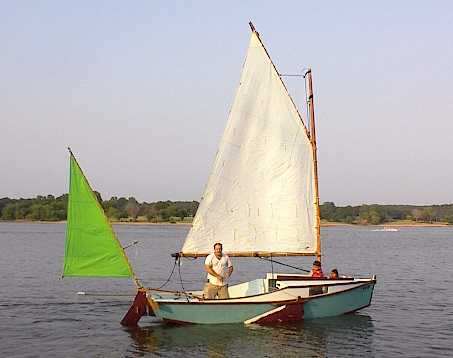

The pivoting leeboard has several advantages. They are easily built and altered. There are no holes required through the hull except for the pivot hole. Best of all the leeboard takes up no room on the boat's interior. On the Slam Dink that same board mounted as a centerboard would take up the whole interior. You could see the same situation below on Richard Spelling's AF2 (shown with an experimental mizzen sail).

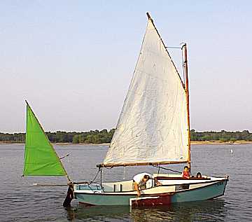

So in that AF2 photo Richard is releasing a line that secures the leeboard in the up position.
How to get the board down? Easy. There is an ear attached to the upper aft edge of the leeboard that sticks up through the upper guard and there is a lanyard attached to it. Grab the lanyard and pull back on it and the leeboard rotates down until it goes kerplunk against the aft end of the slot in the upper guard. Here is Richard hauling the board down.

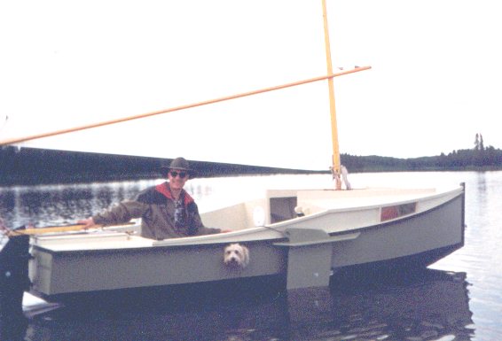

No one has done that but some of those boats have lanyards running fore and aft to be captured by cleats on the fore and aft decks. So you can pull the board around like a puppet in any direction. Here is a photo of Karl James' Jewelbox chuckling along. You can see here the leeboard, the upper and lower guard, pivot bolt, and a loose lanyard running outside the hull to a cleat on the aft deck. (There is also a line running forward but it's not really visible.) You can see there is no tension required in that lanyard to keep the board in the down postion.
