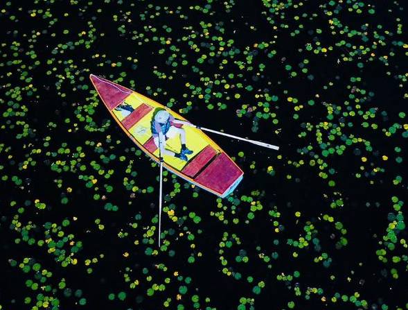

Sean McCambridge's Robote, from above...
