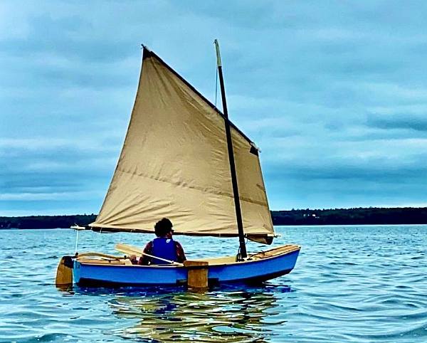

Another Sean McCambridge photo, this time with the "other" Piccup on the water (he has two in the family).
