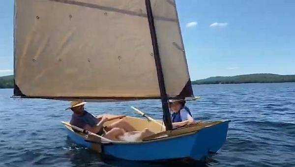

Left:.
Goodkebo, his YouTube name, has uploaded a great video of his build and first sail of his Piccup Pram. Twenty minutes long at https://www.youtube.com/watch?v=PALbuT93Bw8 . (I suspect he might be Sean McCambridge's brother.)
