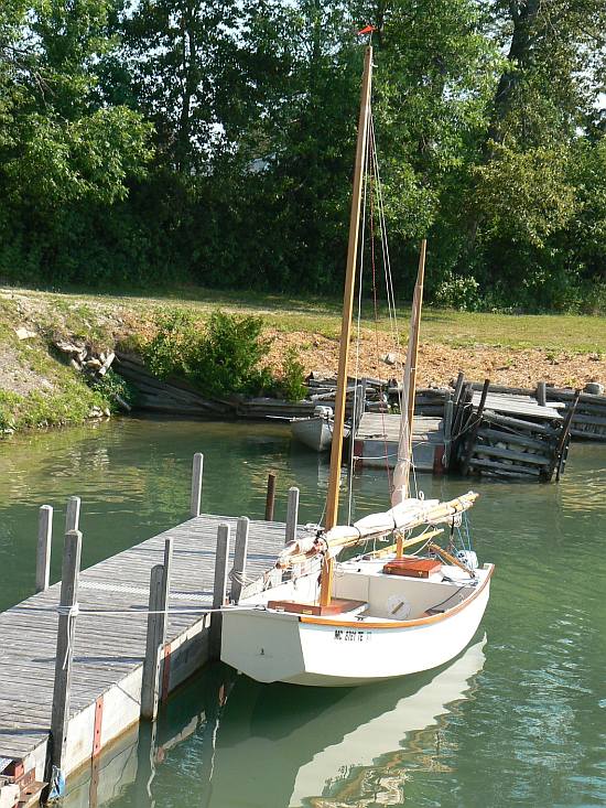

Dave Chase's great Mikesboat again, at the dock.
