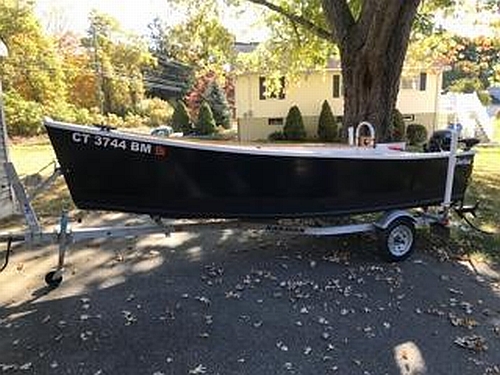

And what is this?? Martin Jaffe built and boated in his AF4 Breve for a while until he realized he needed more day use space and less (far less) cabin space. So he cut off the cabin and installed benches left and right.
