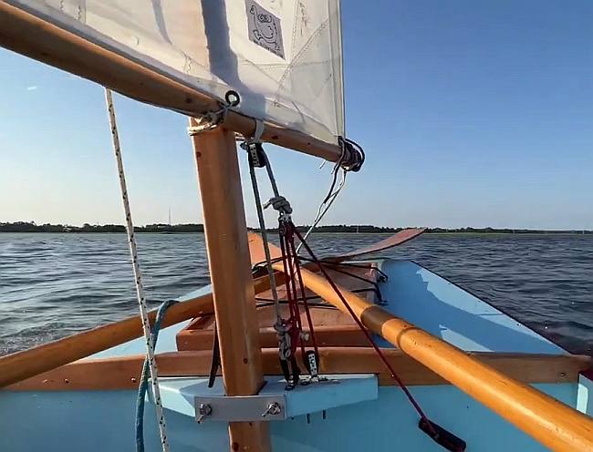

Sean McCambridge posted a cool youtube video of sailing his Piccup at https://www.youtube.com/watch?v=Js7jtcziMX0 . Here is a screen shot from it. I wanted to show his boom tack line solution. He has a heavy line from hull, over the boom, and back down. That is how I do it to a cleat on the hull, giving a 2 to 1 purchase. He has tied a double block to the downward end of that line. Then a lighter red line is tied to the hull, then up through the double block, back down to another block tied to the hull, then up to the double block again, then down again to a cleat on the hull. So he now has a four part system attached to the end of the two part system and, in theory, has a simple 8 part system. Ten pounds of force at the red line cleat gives 80 pounds pulling down on the boom (in a world without friction). That force is resisted by the halyard and stretches the sail tight. It also makes for 80 pounds on the halyard with is doubled over the mast head so there is now 160 pounds of compressive force in the mast.
