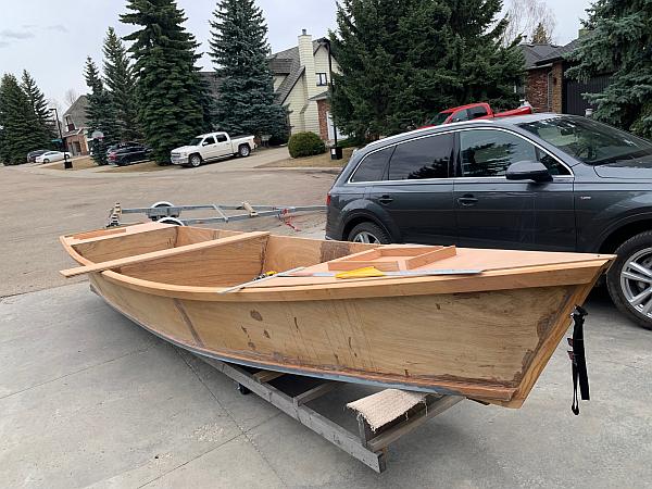

Ross Langford has a Laguna well along. (But, be warned, "the last 15% takes 85% of the time" an old timer once told me.)
