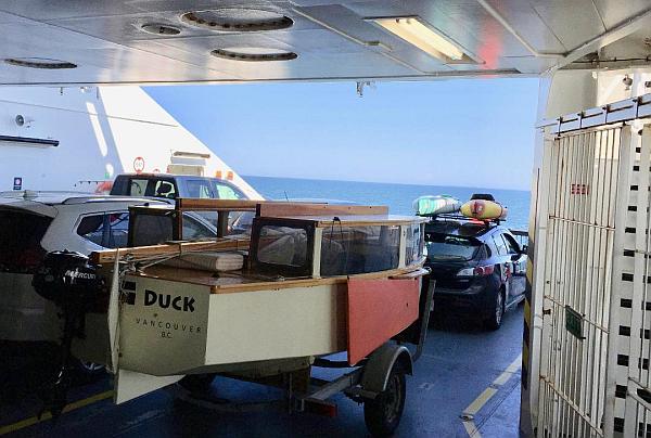

We got kind of damp there in the rain, so we pulled the boat out and trailed to the other (east) coast of Vancouver Island, where we finished our trip in warm, dry weather and 5-10-knot winds. The beautiful, sculpted rock formations above are on the west side of Valdes Island. That�s the beauty of this design: we can go where the weather�s good (by ferry if necessary�as in the photo below), unlike bigger boats that have a short range and have to stay put and wait for the weather to change.

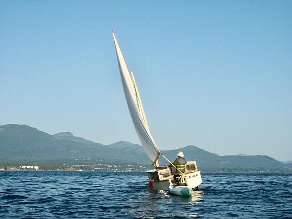

We love the protected feeling of sailing this boat in stronger winds and waves. With all 3 ballast tanks full of water and 2 reefs in the sail, Duck can handle some major weather. During an early October trip few years ago, the northwest wind got close to 20 knots, with waves up to 3 feet high. With ballast and reefs, we bounced to our destination slightly damp (Duck has a Plexiglas front window with weather-stripping to block the forward opening) but nothing broke and we never felt in danger.

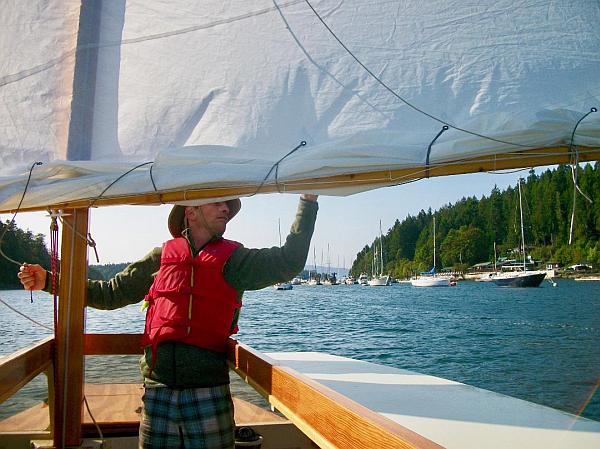

I added a hefty 4-to-1 downhaul to help reduce twist and I�m experimenting with a backhaul to keep the boom from sliding forward when sailing upwind. I�d like to improve our tacking angle, which seems stuck around 120 degrees.

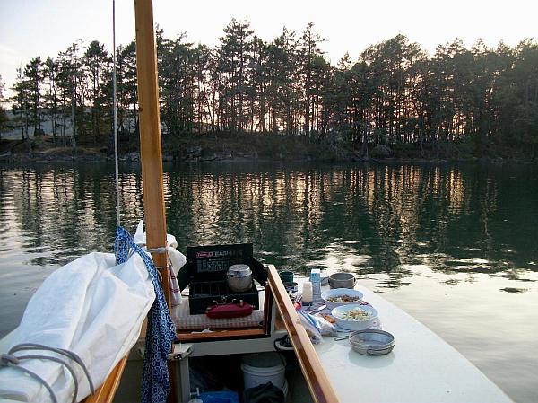

When we cruise, we keep food, cooking gear and sleeping bags under the forward deck. We cook on the forward deck, use the starboard cabin top as a serving table, and rest comfortably on thick cushions in the cabin. Cooler, water jug and porta-potty live in the cabin while all boat parts, ropes and navigation stuff live under the after deck. I keep charts, GPS and nav books in a big waterproof box under the tiller. We carry flares, a VHF radio, a fire extinguisher, and even battery powered running lights in case we get caught out after dark. We�ve never used those. Getting stuff into and out of the storage spaces gets more taxing as we age (both 62 now) but we�re willing to do it for a while yet.
