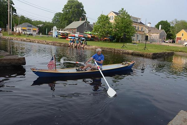

Jon Aborn again, trying out one of the Battos his class built. They put in all the nice details of the original Pete Culler Otter design but be warned my Batto copy of that boat is bare bones.
