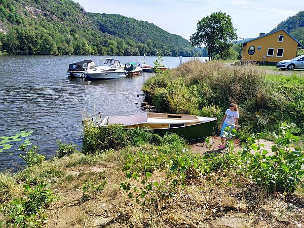

Olin in the Czech Republic has posted many many af4 construction photos at https://olin77.rajce.idnes.cz/Moje_stavba_lode_AF4 and a cruise video at https://youtu.be/kYayUUmIJ1Y

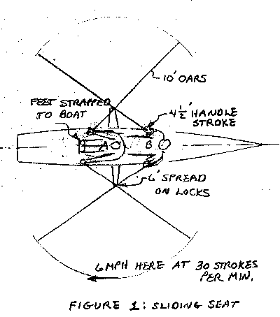

Figure 1 shows the usual sliding seat arrangement. Here the rower sits on a seat that slides on rails, his feet are strapped into shoes which are fastened to the hull. In position A, the start of the stroke, the oarsman has his arms extended and his knees drawn up such that his hands are near his ankles. By extending his legs on the power stroke at the same time as he pulls on the oars, the rower greatly increases the length of his stroke compared to a fixed seat. The seat looks to be sliding about 2' during the stroke. In the diagram he has about 4-1/2' of oar handle stroke, about a 50% increase over a fixed seat. If the cadence of the stroke is the same as for a fixed seat, a 50% increase in horsepower would result. (He might also pull with a lot more force on the handles, but remember all the force he generates will transfer through his arms and hands. So I wouldn't expect a large increase in handle force in a long run.)
All the forces produced on the rower's hands are reacted through his feet alone and the human body is well built for that. None of the force reacts through butt friction.

All these things may be worth the bother if you are the right person in the right boat. But maybe not. As shown in the figure I dreamed up for Roar2, a 50% increase of the power will increase boat speed about 15% . Instead of going 4 knots at full stretch with a fixed seat you might make 4-1/2 or 5 knots with a sliding seat. Normally I advise against it for a shorter boat. A longer narrow boat will probably be needed to take advantage of the sliding seat.
