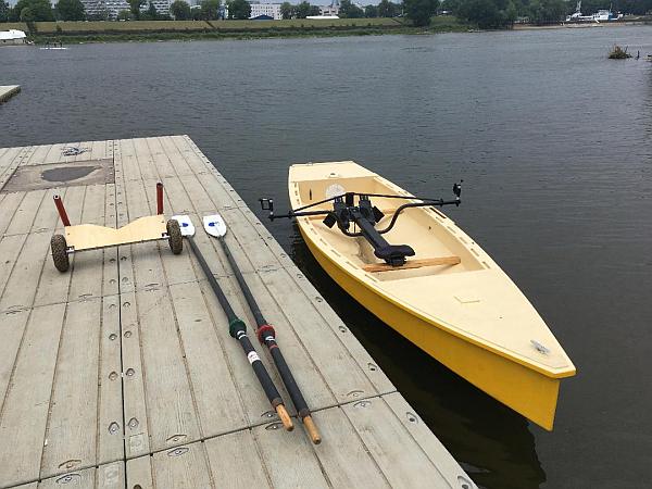

Wojtech Baginski's Robote set for a brisk workout, in Warsaw, Poland.
