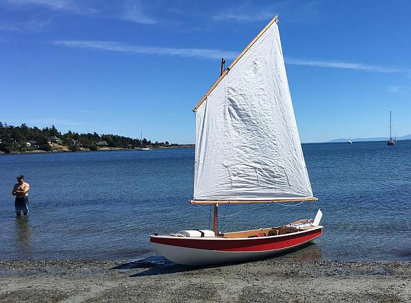

Eric Light's new Mixer2 in British Columbia. Take a look at https://golightlythroughthisworld.blogspot.ca/
