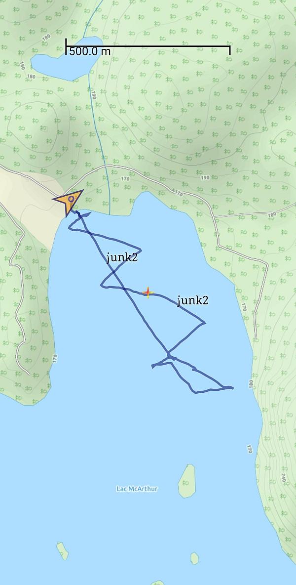

I finally had a moment to take my protractor and measure the tack angles on the GPS track I forwarded to you. From the screen shot I measured:
(50� + 60� + 50� + 75� + 70�) � 5 = 60� (the decimal is meaningless)
My compass is showing that I my headings on a tack are about 105� to 110� apart.
This average of about 60� when tacking confirms my suspicion that when close hauled with the Chinese lug rig in light wind there is lee way of about 10�.
Still waiting for a stronger wind.
