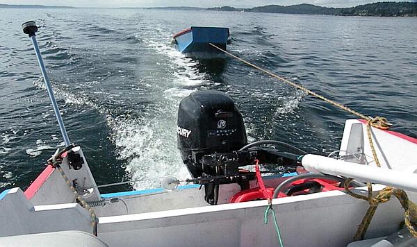

Bob Holley towing a Moby Dink with his AF4B.
