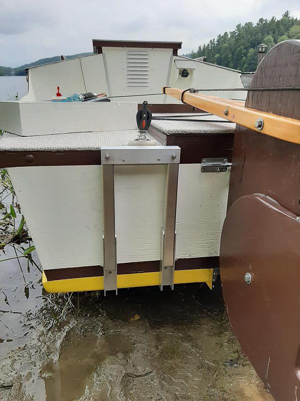

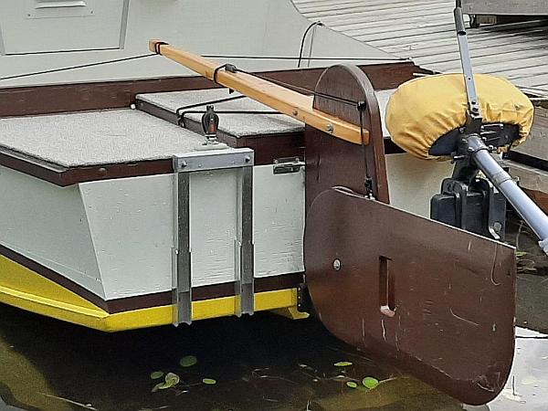

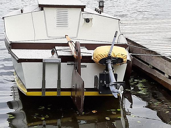

Herb McLeod reboards OliveOyl the old way, with the toe slot cut into the rudder.
Herb's OliveOyl 3
HERB MCLEOD WROTE...

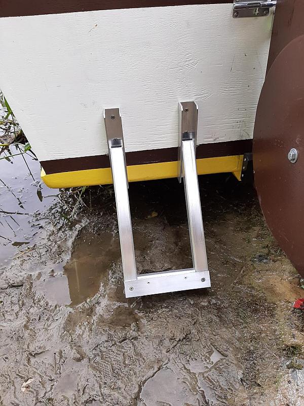

..."I sometimed keep OliveOyl on a mooring ring in water 3 to 4 feet deep rather than on the dock. When I do this I usually store the boat with the rudder in the cuddy. The other day rather than using another boat to get to her I waded out to OliveOyl only to realize that I could not easily clamber on board without the rudder in place. Time for a boarding step. I made one from 1 1/4 inch square tube and 1 1/2 inch channel aluminum (cost on materials about $25 USD). The step also makes reboarding after capsize recovery much easier."
THOUGHTS...
...Almost no one could reboard a wall sided boat without some helping device. A rope might do it. The toe slot you see in Herb's photos was my early and cheap effort. But the toe slot can come with a few warnings. First the rudder and its fittings need to be strong enough to support the weight of a waterlogged and scared boater. Then when he gets a leg up, he has to climb over things like the tiller and assorted fittings.
Now Herb's ladder is much much better and about mandatory if you are boating with folks who aren't strong and nimble. I have never found a rope ladder to work at all - my legs swing under the shallow bottomed boat and you are stuck there. Perhaps with practice and getting things set just right. You might review Richard Woods' demo of this problem. He used a simple boarding stirrup but took pains to adjust it just right with a few trials. Plus he is strong and nimble.
I think to be successful the ladder has to store flipped up and out of the way of ropes that can snag it and ruin your day (as they can snagged an outboard motor). You need to be able to unfold it while swimming. It has to be strong enough for the waterlogged and scared boater. It can't have any sharp edges to gouge him either.
