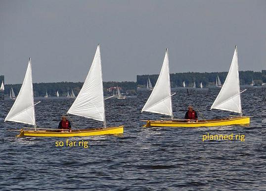

Wojtech Baginski dreams of changing his sailing rig on his Robote. Wants smaller area and move mainsail forward to keep from hitting his head. Looks like he is racing himself, doesn't it.

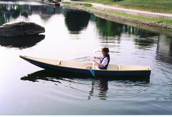

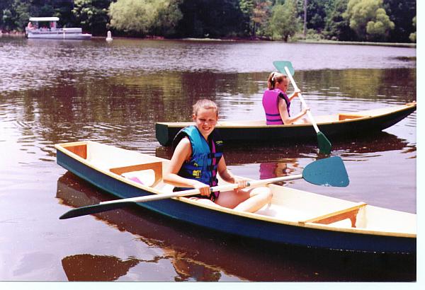

"GIRLS, AGE 11, BUILD TOTO
Small boat tinkering led me to the Small Boat Messabout in southern Indiana and Illinois. Phil Bolger�s building ideas were key to this movement. I built his Windsprint and later his iconic Birdwatcher. Accompanying me on these weekend messabout excursions was my eldest daughter, Kim, who enjoyed the camping, boating, and attention from the adults.
At the conclusion of her sixth grade I ask her if she and her friend, Hadley, would like to build their own canoes. They both jumped at the idea! It was about three weeks before our next Small Boat Messabout and they wanted to build the boats to take along. We chose Jim Michalak�s Toto and I emphasized to the girls that I would only supervise their work but they would do all the building themselves. They enthusiastically agreed.

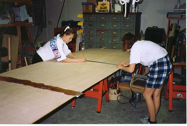

First, I showed the girls how to measure and lay out the offsets from the plans and they went to work on the scarfed sheets of Luan.

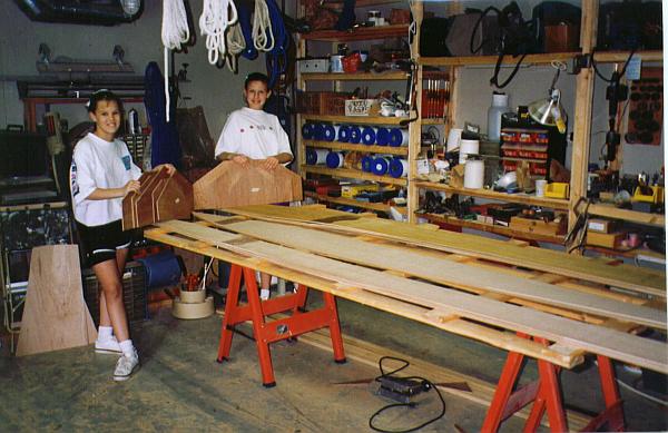

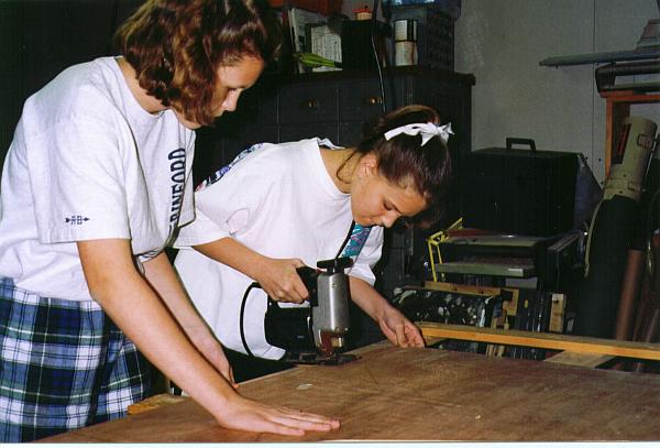

Next came the cutting out of various parts. Using the jigsaw was a new experience but they mastered it quickly!

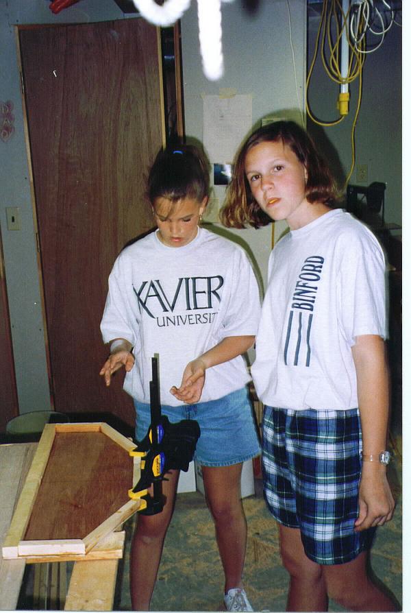

Then they glued the frames.

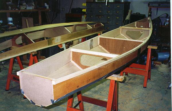

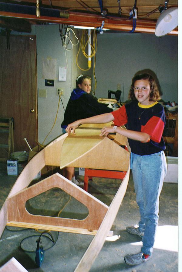

Attaching the sides and bottom to the frames and it is starting to take shape!
The last panel is inserted and with one girl below passing the copper wire through pre-drilled holes and the other on top twisting them together they completed the stitching process.

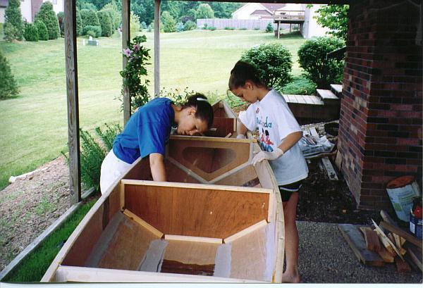

One boat is duct taped and turned upright ready for filleting with filled resin.

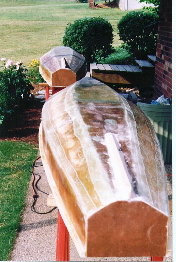

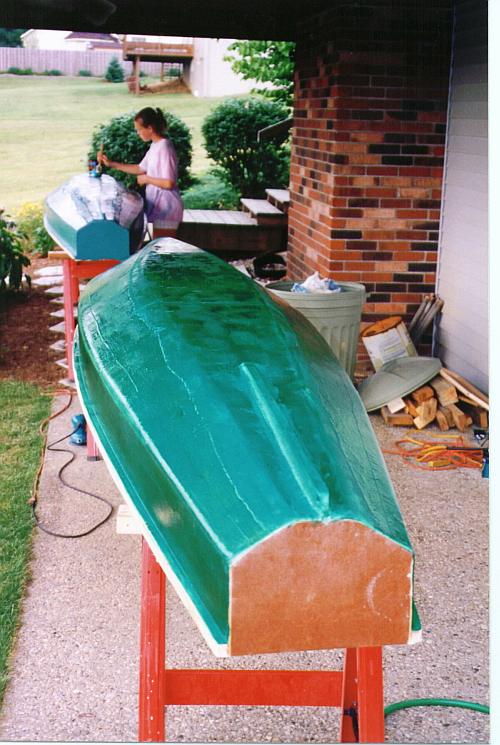

Inverted once again, the wires are trimmed and the seams smoothed for the outside taping to proceed. Here the seams are taped and the bottom is glassed. When dry they will begin painting them with their color of choice.

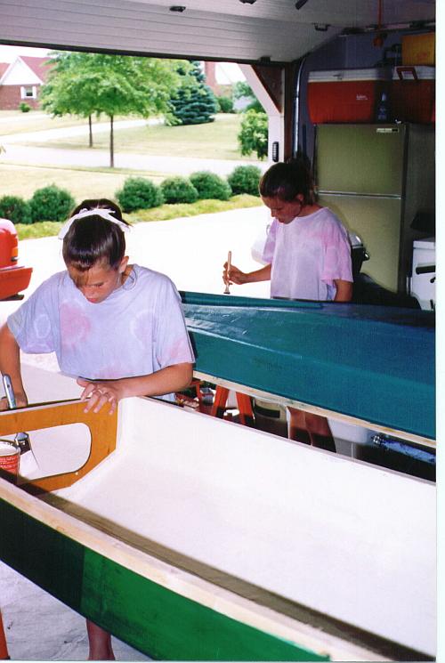

Let the painting begin!
With the threat of rain they moved to the garage and decided to paint the interior white to accent the natural wood of the frames.
Painting the paddles...
NICE JOB LADIES!!

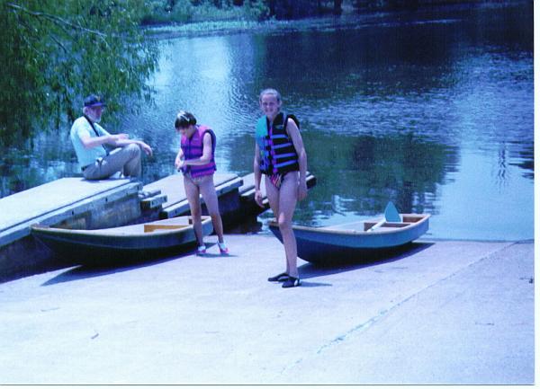

It is finally time for sea trials!
And on the launch ramp at Rend Lake three weeks later!
What a sense of accomplishment for two industrious young ladies!
Building confidence and memories for years in the future!
