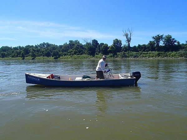

Brian Nimmo gets comfortable for a river run with his Brucesboat.
