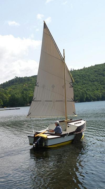

I built the Chinese lug sail after sailing with local enthusiasts who likes to experiment with different rigs had me out on one of their boat for a day of sailing: http://www.workingsail.com/index.html

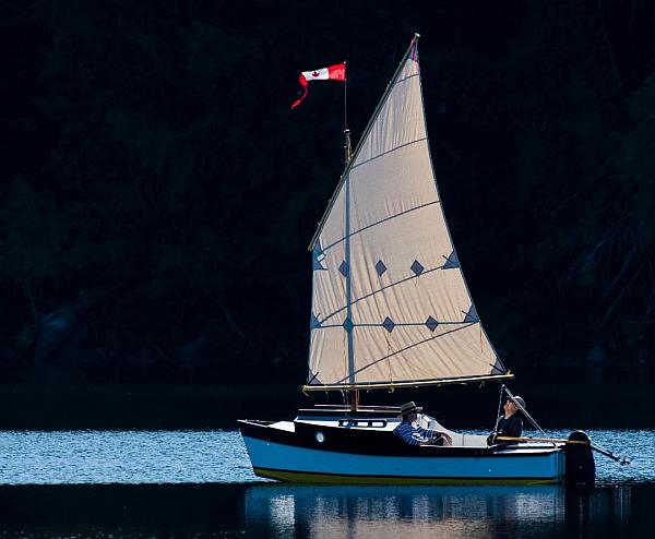

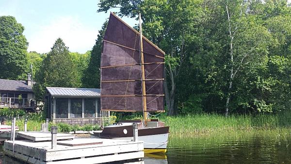

The Chinese lug in made on the lines of a Duck Works article by Albertan Mike Mulcahy. I used a 10 oz 12' x 15' canvas painting tarp bought at Home Depot rather than the poly-tarp. To make for a rapid setup I did use the snap buckles and snap hooks as he showed in his article. I also added the Gurney Flap and built in some camber. I used half the camber that he suggested for the poly-tarp which turns out to have been a bit of a mistake. My experience with the canvas lug sail is the broad seam darts are made at about half as wide as one would sew into Dacron. The canvas stretched out to give what looks like a nice belly to my balanced Lug. So far the 22 inch wide panels on the Chinese lug have shown no tendency to stretch even in +20 knot winds.
The tie dye colour was a result of my attempt at mixing a canvas waterproofing with a burnt sienna pigment. On my test batch it worked fine but when I tried to make a larger batch the pigment settled to the bottom of the can too quickly. The top 4 feet of sail have a much more even colour as here I learned to mix up only half a quart at a time and I would keep keep the pigment suspended by swirling my brush each time I dipped it into the can.
I also see that one of my spars is not in the right place. Something that can happen when building a sail in a space that only allows layout half of the sail at a time :-) One suggestion that I have since from from a a local fellow sailor that likes to experiment with different rigs is to build all the sail panels separately and then lace them to the battens.
The Mike Mulcahy article: http://www.duckworksmagazine.com/06/howto/junkrig/index.htm
I found the read in Wikipedia about the Gurney flap interesting. I suspect you already know the story about Dan Gurney: https://en.wikipedia.org/wiki/Gurney_flap

The 10oz canvas Chinese lug sail with spars and lines weighs 36 pounds. (Plus mast 58 pounds)

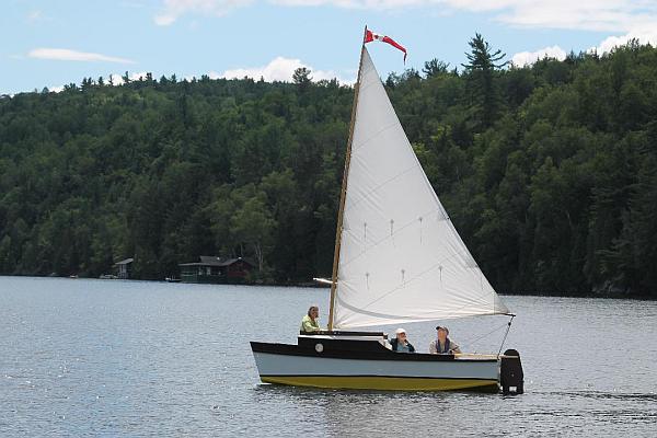

Reefing: We had +20 knot winds the second day and I was impressed as to how docile the Chinese lug was. We were able to decrease or increase the sail area on the fly something that could likely not be done with the balanced lug and definitely not with the leg-o-mutton. At one point we reduced the Chinese lug sail by reefing the three bottom panels and were still able to sail to windward in the +20 knot winds. The Chinese lug sail enthusiasts with me on OliveOyl noted that this was interesting as the sail area was probably close to the windage of the hull. Also raising and lowering the Chinese lug in a blow was was not as dangerous as with the balanced lug as it is at all times well tamed. The one time I came close to capsize with the balanced lug was when I was raising the sail and when it was about half way up I was caught by a strong gust of wind. The sail then billowed out like a spinnaker and came very close to dumping the boat on its side. I saved the situation by letting go of the halyard and dropping to the floor to get my weight as low as possible.

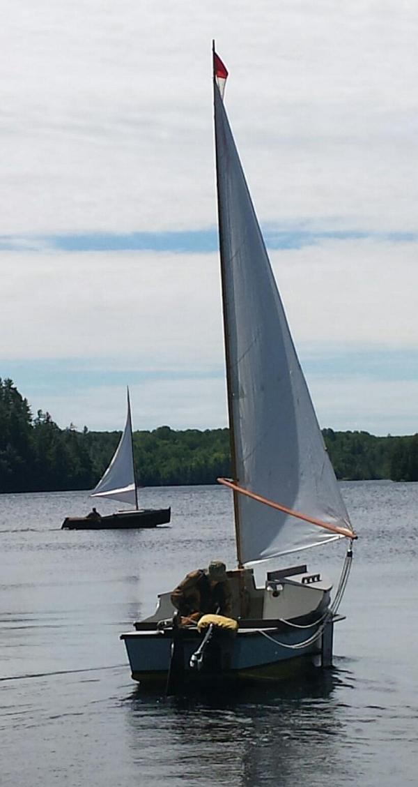

AF3 and OliveOyl: On another topic Gord was by with his 20 year old AF3 on his way back from Qu�bec to Alberta. We had a good deal of wind and were able to sail the two boats side by side for a day. I have attached a photo of that occasion. Below is what I wrote to the Working Sail group following that event:
Gord arrived at lac McA with his AF3 and we went sailing with both boats using the exact same leg-o-mutton sails on both boats. In the light wind the AF3 was a bit faster than OliveOyl but when it started to blow Gord had to reef the AF3 to keep things from getting scary while OliveOyl was able to comfortably carry the full rig. We later changed masts on OliveOyl and put on the 110 square foot canvas lug sail.
Generally we found that we preferred the lug sail as the mast is easier to handle. Set up is a slightly slower with the lug sail as there are the reefing lines to deal with. That said the lug sail easier to raise and lower in the windy conditions and we could heave to with the lug which I have not been able to manage with the leg-o-mutton.
