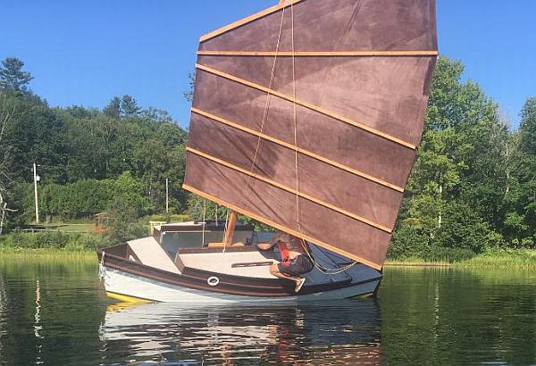

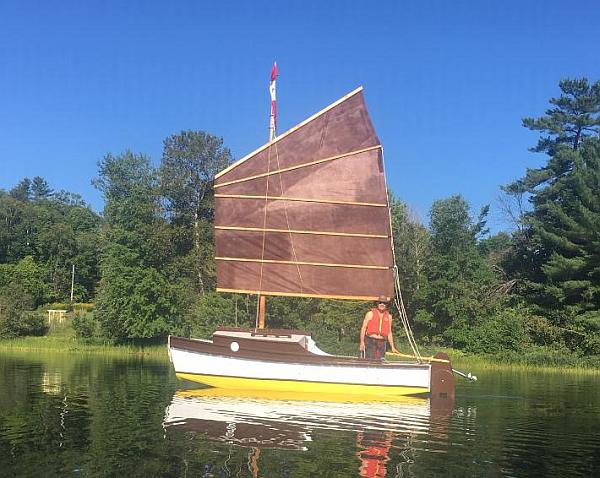

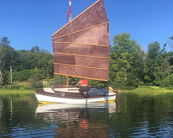

Herb McLeod capsizes his junk rigged OliveOyl.

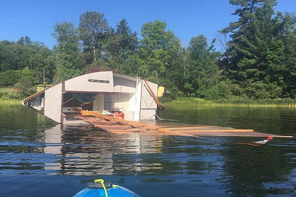

Hi Jim,

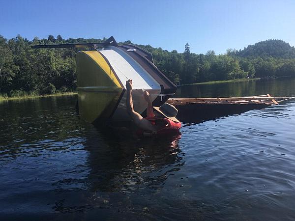

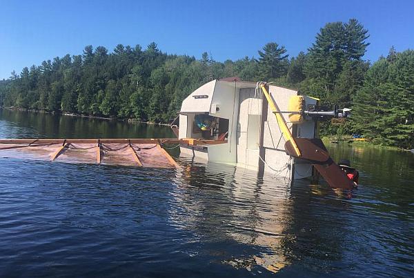

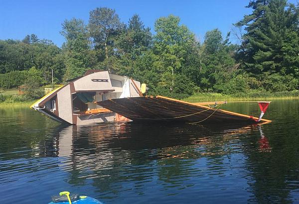

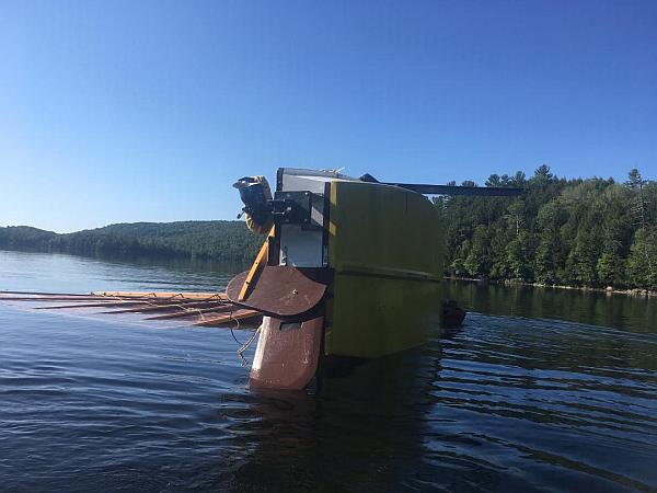

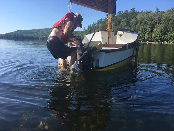

"Hi Jim, A neighbour and fellow sailer Bob Huson came by on his Kayak. There was no wind and the junk sail was on the boat so asked him to take some pics with his smart phone when I capsized and recovered OlivOyl. It was a little easier to pull OliveOyl over with heavier junk rig but still took considerable effort on my part. As she went over, unlike the AF3, it was v-e-r-y s-l-o-w. To right her when the board is on the high side I have a 1/4 inch line attached with a snap fastener from the bow ring the lower offcenter board bracket. It didn't take much of a tug to pull the boat up using this line. Perhaps 10 pounds or so of pull. The boat is ballasted with the 100 pounds of lead in the bow. This keeps it level when I am sailing from the cockpit. The lead also keeps the bow of the boat down when it is on its side so that the centerline of the boat is parallel to the surface of the water. "

...we'll take a look at Herb's boarding ladder.
