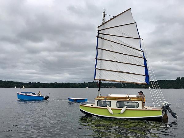

Bob Holley in background AF4B towing Moby. Dennis McFadden in foreground in a very developed Scram. (Sorry, I don't know any details about the Scram mods.)

Scram Pram is an interesting boat that I designed for Wil Gordon of Houston a few years ago. He built the prototype shown above, including making that multicolored sail. Wil had owned some production pocket cruisers and had sailed in Karl James' Jewelbox. He wanted a huge rig all in one sail for moving in very light winds. We started the design process by enlarging IMB and it turns out that at least two Scrams have been built while the prototype IMB is still abuilding.
scram
The lines show that Scram has a multichined cross section, like my Piccup Pram, and I've found that makes for a very fast and seaworthy boat. The top is built up like a Birdwatcher. Everyone sits inside, including the skipper. The boat can also be steered by sitting in the open top slot as shown in the photo. The top of the cabin has a slot that runs full length. If you sit to the side you are inside under the deck, but you can stand up in the middle. In bad weather the slot is covered with a snap-on tarp. If you have children this is a good boat type because they will never be on deck. If you use tinted plastic for the windows and a white hull, the boat will be cool in hot weather.
But the main advantage for the Birdwatcher cabin, invented by Phil Bolger, is that the crew sits low and the crew's weight acts as ballast, instead of making a boat top heavy as with a normal cruiser where you sit on a raised deck. Sometimes the effect is so strong that the Birdwatcher boat will be quite self righting with no ballast other than the crew weight. So you can get a nice light simple self righting cruiser. With Scram it didn't quite make it. In tests of the prototype, the boat was just barely self righting with a crew of one against the floor when the boat was rolled over 90 degrees by a rope attached to the masthead. But the design has water ballast tanks on the floor to take 300 pounds of water. With the tanks full the boat is so stable that the test crew had trouble rolling the boat 90 degrees with the mast rope. When released, Scram popped right up. The testing was done by Tim Weber of Houston and was written up in this web site last year. You can access the back issues to review. Tim felt that Scram would be OK with 100 pounds of ballast and that there was little need for more than 200 pounds.
