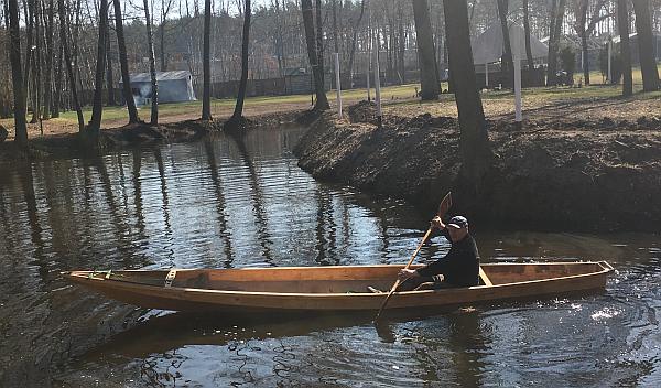

Michal Adamczyk in Warsaw, Poland, gets a test launch with his new Marksbark, the only one I know of. It is supposed to be a canoe/sliding seat rowboat. Looks great!
