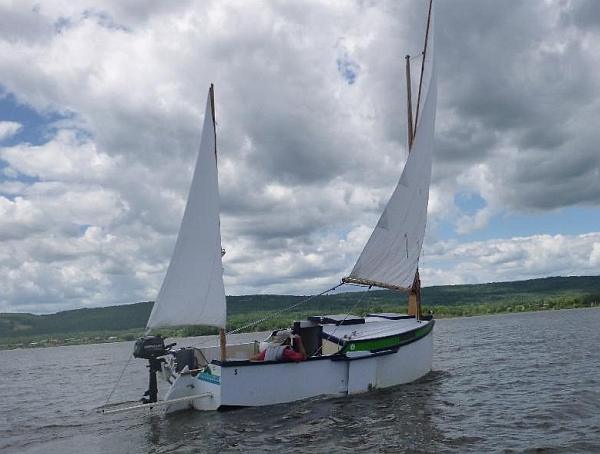

Kenny Giles and his Picara write, " These are from Cap�n Dave; 2019 season, St Lewis River, 8 miles south of Lake Superior." Ken has put many miles under the Picara leeboard.
