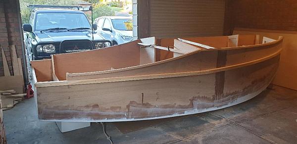

Steve's DownUnder Blobster project is at the stage where you can crawl inside and play boat.

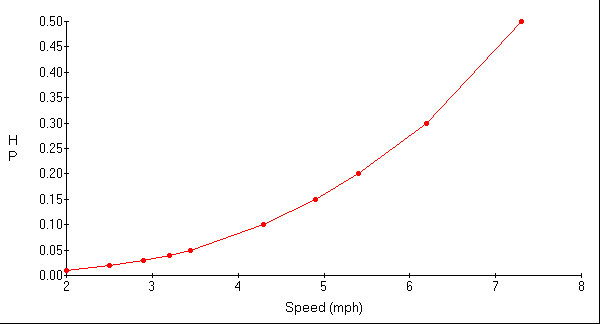

Well, we're not out to win the Tour de France. To a certain extent with a rowing boat, the issue of power delivered becomes moot. The nature of hull drag for boats that don't plane assures that they all go about the same speed. Figure 2 shows what I think the power requirements might be for a boat like my Roar2 in normal one man rowing trim. (These power figures are all guesses.) You can see that power required rises sharply at a hull speed of about 4.5 mph. With a steady 1/20 hp of our rec rower she wants to go 3.5 mph. With 1/10 continous hp, say a maximum power for a short burst of arm power, or an easy continuous power for a small electric trolling motor, she wants to go 4.3 mph. The Tour de France winner might go 7 mph if his arms were as strong as his legs. A tenfold increase in power gives only about a twofold increase in speed.
The point is that large increases in power give only small increases in speed once "hull speed" is neared. So for recreational use it's wise to think in terms of easy steady power that you can maintain for hours, if needed. The big power can be held back for use in hard conditions like pushing into a wind, through a current, or past some rough water.

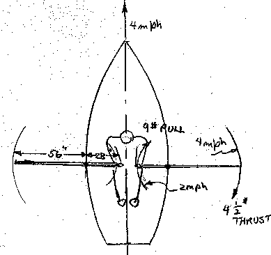

So let's say the skipper is pulling the boat through the water at 4mph. But his hands are only moving 2 mph! The oar makes the difference in speed easily possible.
If the oar were 84" long (7 feet), and 56" of that were outside the lock, and 28" were outside the lock, then a 2 to 1 ratio will be achieved.

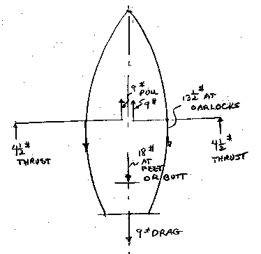

Figure of 3 shows the "freebody" diagrams (the balance of forces) of the oar and the rower and the boat. With the configuration shown the 18 pound load as a 9 pound load on each handle is balanced by a 4.5 pound load on each blade. So the process of gearing up the speed by a factor of 2 has also reduced the balance load on the blade of the oar by a factor of 2.
The forces on the rower's body are also shown in Figure 3. His 18 pounds of force in his hands must be reacted to the boat some way. If he has no feet bracing at all, then the force goes out of his body as friction where he sits. It can hurt a bit after a while! The usual solution is to brace the feet solidly. A handy bulkhead or hull frame might do. Custom cleats for the feet to push against attached to the hull are also common.
If the rower now turns downwind he may find his 1/10th half time horse will push the boat at 5 mph. To get that without changing his stroke he can slide the oars out so that he has 24" inboard and 60" outboards. As shown in Figure 4 he will now have 3.6 pounds of force at the blade of the oar. Less force is required there now since the wind is helping to push the boat along.
Now let's imagine the rower encounters a headwind that slows the boat to 3 mph. How does he match his 1/10 th intermitant horsepower to the new speed? If the rower slides the oars in so that 32" is inboard of the locks and 52" is outboard, his 2mph, 9 pound application at each handle will be geared up to 3.2mph at the blades. As shown in Figure 4 the blade will balance now with 5.5 pounds of force at the blade. That's an increase over the first condition and it's that extra blade force that will help push through the headwind.
