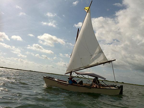

Chuck Leinweber sent this photo of Gordon and Mathew Barcomb in their Mayfly14 all decked out for the Texas200.
