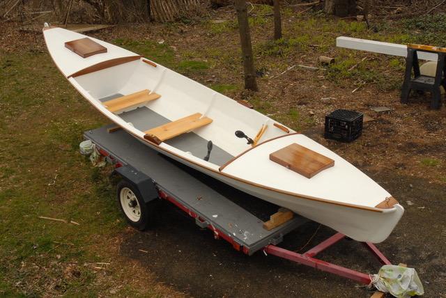

Mike Fittipaldi finished this great super delux LFH17. Drawn as an open boat, he added the end chambers and seats. Says it is quite fast with his 8' oars.
