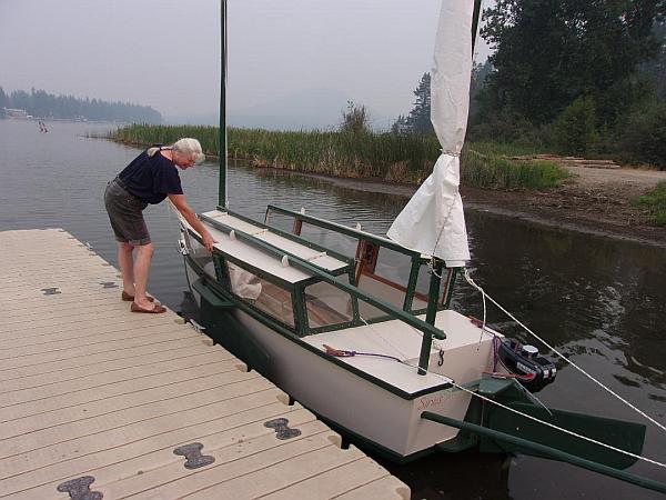

So in that AF2 photo Richard is releasing a line that secures the leeboard in the up position.
How to get the board down? Easy. There is an ear attached to the upper aft edge of the leeboard that sticks up through the upper guard and there is a lanyard attached to it. Grab the lanyard and pull back on it and the leeboard rotates down until it goes kerplunk against the aft end of the slot in the upper guard. Here is Richard hauling the board down.
