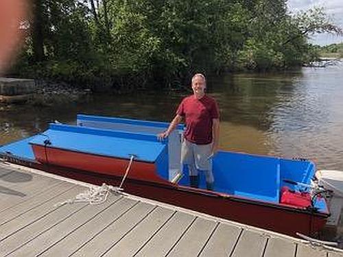

Dan Vanderweyden writes, "I have splashed my Campjon, yay. It performs just as you said, lively with a 10hp Long shaft two stroke (21mph at WOT) yet stable enough to walk around in. I raised the cabin topsides 6�; the rest of the hull follows your specifications exactly."
