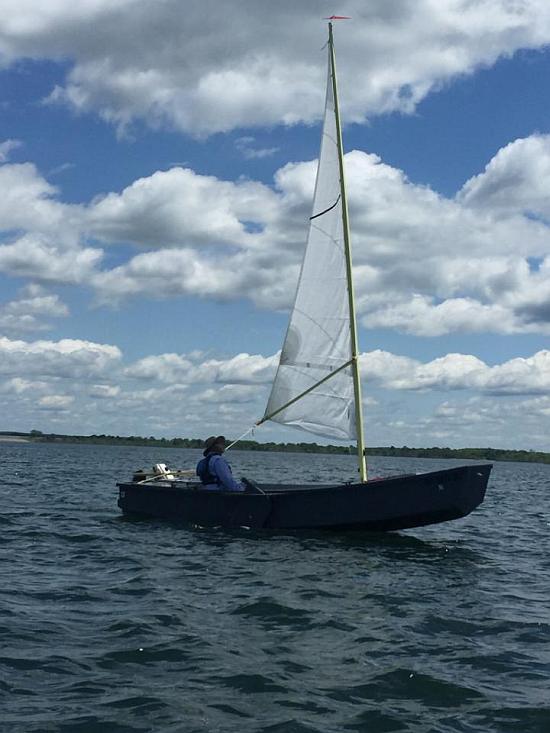

Gene Berry looks at his Mikesboat rig on its maiden voyage. Note that he has swept the leeboard aft to trim away some weather helm. Lots of weight in the stern looks bad trimwise but doesn't seem to hurt the sailing.
