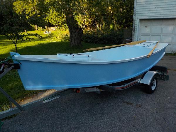

Jamie Saunder finished this fine Mayfly14 in Canada and whittled out a great set of oars too!
