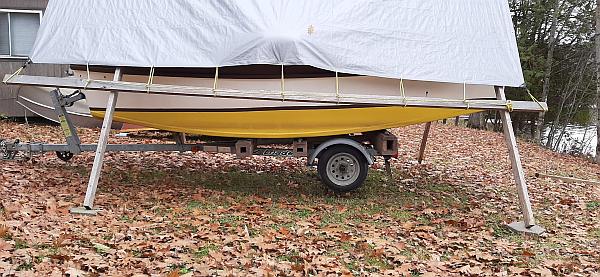

It is getting cool here. We have now had three frosts and they are forecasting a possible snow fall on Monday. We are ready for this weather event having completed the fall garden cleanup; placed the snow tires are on the car and taken OliveOyl is out of the water.

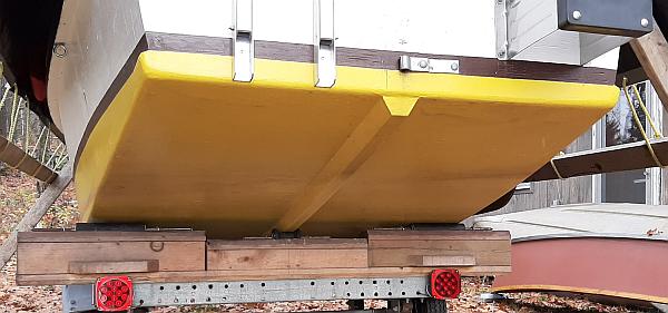

OliveOyl spent all of this Covid-19 summer in the water and when I pulled her out and up on the blocks I noted that there was a distinct line all around the boat showing exactly what part of the hull was under water while moored to the dock. (See attached pictures}.

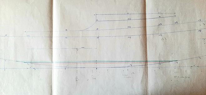

After your recent essays on calculating the displacement of a design I thought to myself, �I can figure out how much my version of OliveOyl weighs!� My OliveOyl sits on the water leaning to the starboard side. I then measured the depth at midpoint on both port and starboard and where at the bow and the stern the hull exited the water on both sides. Next I pulled out the lines drawing and drew lines representing the starboard (green) and port (red)water lines and a third line (blue)in the middle that halved measurement differences between the starboard and port. (There was a goof in my initial measurements so there are two red and two green lines.) All three lines are parallel so using the middle line I worked out on the plans a curve of areas for this water line.
My OliveOyl was built from 3/8 spruce ply for the sides and 5/8 on the bottom. One sheet of 3/8 spruce ply weighs 30 pounds which is the same weight as a sheet of � inch fir plywood but the boat gains an extra quarter inch of beam and an extra 1/8 inch of depth on the outside chines due to the thicker plywood. I took all this into account in my calculations. When tied to the dock the mast and sail are not onboard and the ballasted rudder is raised to be completely out of the water.
My calculations showed that OliveOyl with the hatch cover on but without mast and sail was displacing 651 pounds.
Next I subtracted the following: 100 pounds of lead ballast, 25 pounds for the electric motor and mount, 10 pounds (estimated) for the anchor and chain, 30 pounds (estimated) for other gear, Life jackets, cushions, tools, spare parts, fire extinguisher, paddle, boom crutch, bucket, step-stool, boarding ladder.
This indicates to me that the OliveOly hull weighs 486 pounds which is close enough for me to your estimate of 500 pounds.
Working backwards from the Curve of Areas calculation, I calculated that the Prismatic Coefficient for the OliveOly when moored dockside is 0.57.
There are no surprises in any of this but I have always wondered what OliveOyl weighs. I now think I have a pretty close estimate short of driving 8.5 Kilometers to the local gravel quarry and then begging them to weigh my rig twice, both with and without the boat.
