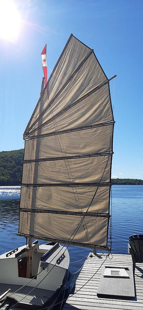

1) I had to replace the second from the top batten extending it so that the sheetlets would not hang up on the lower battens when tacking. It now works flawlessly both when tacking and jibing.

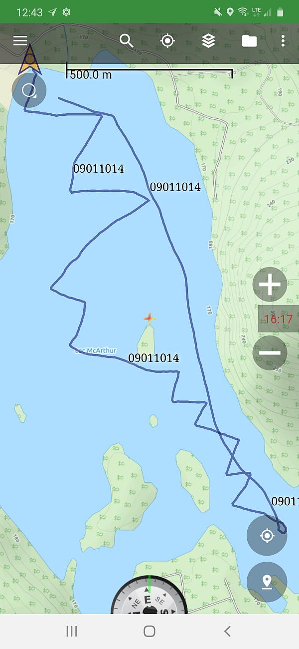

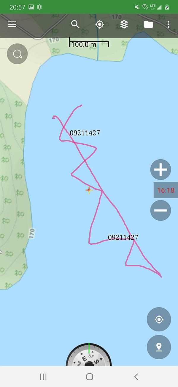

2) I did record a couple of tracks of mostly short tacks into the wind followed by a downwind run where I kept the pendant on the masthead pointing directly downwind. I purposely did not take advantage of any wind shifts when tacking. Unfortunately there was never a smooth gust free wind to record the tracks but my impression is this sail is about as close winded as the spritsail and more powerful in light air as it has a 25% greater sail area.
3) Also the shorter boom compared to that of the spritsail has eliminated two problems. First the sheet getting caught on the corners of the stern of the boat. Second the shorter boom length eliminates the possibility of the clue of the sail dipping into the water and tripping the boat during a partial knockdown.
4) When I initially installed the junk sail on OliveOyl I used the same vertical mast position as I had for the oversized balanced lug sail. To develop some weather helm I kept moving the mast aft until I felt I had adequate weather helm. Later to help the sail stay out when running downwind in light air the mast was tipped so that it leans forward 5 degrees. At this point I was happy with the balance of the boat and both Jamie and Kirill when they took the boat out remarked without being prompted that the "sail balance was excellent". This forward tipping of the mast really helps the heavier junk rig to stay out when running in light wind.

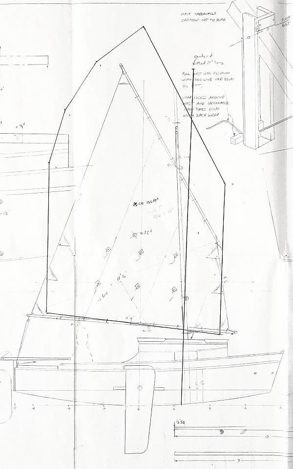

Before I put OliveOyl away for the winter I measured the position of the mast step and partner as well as how far the boom is forward of the mast. I then drew a � to an inch scale drawing of the junk sail and located the geometric center of effort. Then I took your sail plan drawings of the OliveOyl and drew a line that represents the center of the mast as it was finally positioned. I then traced the outline of the junk sail as it is positioned relative to the mast. Interestingly my trial and error positioning of the mast and sail, it ended up with the center of effort in the exact same fore/ aft position that you had drawn for the balanced lug rig. This is an interesting result, but not too surprising.
