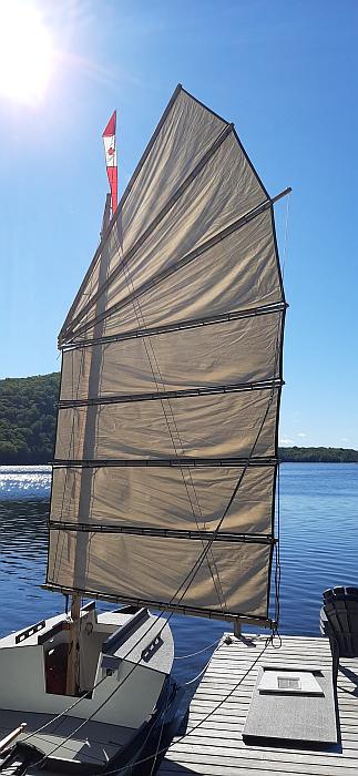

Herb McLeod has a new junk rig on his OliveOyl. More on this to come.
