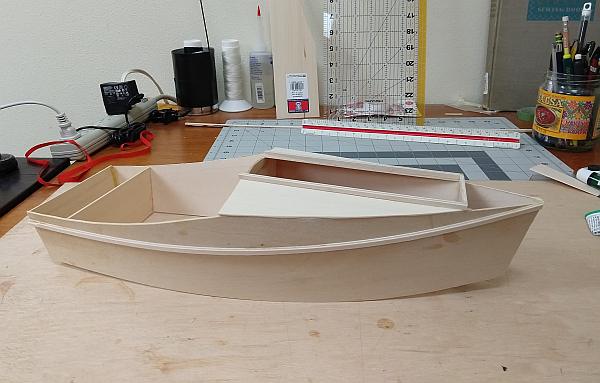

An AF4b model by Ken Preston to practice the details and get the dimensions down. He is working without plans since they aren't available right now and has scaled dimension from the tiny scans in the AF4b writeup. Looks good to me!
