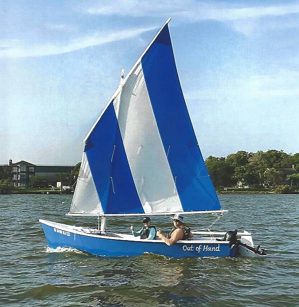

A super Mayfly16 by Reid Scofield in Houston. He writes, "My family and I are enjoying sailing in Clear Lake and Galveston Bay. I am looking forward to the exciting adventures to come!"
