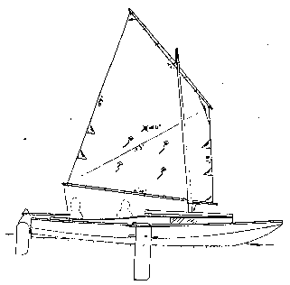

Rigging A Lugsail

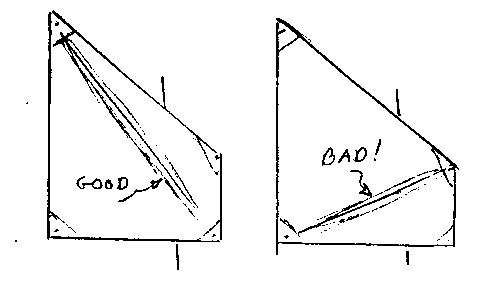

BASIC BALANCE....

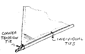

TYING ON THE SAIL...

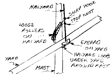

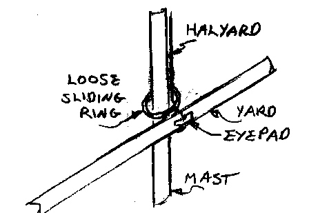

HALYARD/YARD ATTACHMENT...

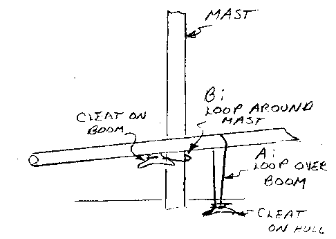

THE TACK LINE....
THE SHEET...
Nothing fancy needed here. Almost anything will work. Because the sail is balance already to a great degree the sheet forces are less than with other sail types. Because the tack is pulling down in the middle of the boom, the boom has less tendency to lift so downward pull of the sheet on the boom is of less importance. The location and lead directions of the sheet are of little importance also. It's another advantage of the balanced boom. By the was, if the boom is omitted to make the sail boomless, the sheet location is very critical and its needs change all the time. I think the boom is a great invention! The boom on a balanced lug can be quite light and still work.
SAILING ADVICE...

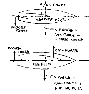

Also it should be mentioned that one of the most effective ways to trim the boat, helm-wise, is to rake the mast as required to move the sail are fore or aft. You can see that a small amount of rake will move the mast head quite a bit and the entire sail will go with the masthead. Old time boats had adjustable mast steps or partners. On my designs you can usually shim the mast partner on the bulkhead. It's one place where tinkering pays off. Making a mast a bit longer than shown on the plans is also almost always a good idea as it allows for this tinkering not to mention real life stretch of the rigging.

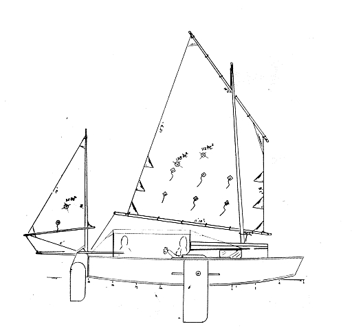

So I drew up my best guess and called it Hapscut.

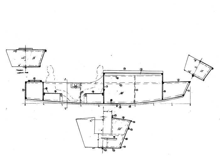

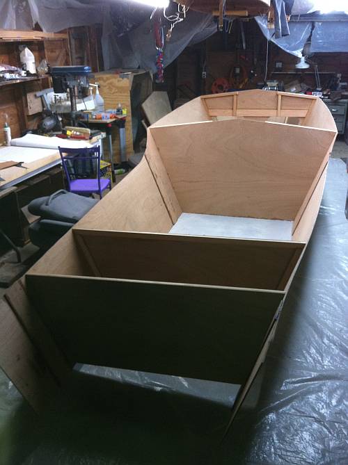

Simple scow flat bottomed square toed hull. Narrow on the bottom so like Laguna it could be planked with 4' wide plywood. Wide on the top, a lot more flare than I normally draw, because I was quite impressed with the small San Francisco Pelican on the trip as it handled 2 grown men in it 12' length with seemingly no problems. Square bow to make beaching easier mostly. The idea is that you can easily stroll through the cabin and out over the bow to avoid stepping at all in any nasty yuck.
The cabin itself is long enough to sleep on the floor but really only wide enough for one person. It is high enough to sit up in and read. It is minimal but I think a big advance over a land tent. Two people could wait out a storm in there. It has the usual slot top so with top stowed it becomes an open boat allowing one to walk from cockpit, through cabin and out the bow without climbing over anything more than 2' tall. With luck the cabin will prevent swamping of the entire boat in a knockdown, another good thing about a large amount of flare in the sides.
The crewmember is supposed to sleep in the cockpit but that requires the quick removal of the two large seating flats. Given a good sun top this might be the preferred place to sleep. On the 2010 trip there were no bugs or mosquitos but if needed you could quickly net in the sides of the cockpit. By the way, the length of the boat is really determined by the need to sleep two on the narrow bottom, thus you need 13' minimum just for that.
Aft of the cockpit is the buoyancy/storage volume. This buoyancy will save your butt in a knockdown since it will support the stern, float the boat level on it side until you recover. Don't compromise it.
One thing I goofed on maybe in Hapscut was that I did not draw a motor well as I did with Laguna. I know if I were building one of these for myself I would have it. Extend the stern back another 18" with the open well ending with a transom angled 15 degrees. Then you could easily mount a motor and store a lot of messy gear back there. The motor sounds like cheating but it can save you butt on occasions and in general you can cover a lot more water even if you seldom use it because you won't play light winds so cautiously. But I don't know if a little motor can save your butt in really rough going.
Although Hapscut was designed for a long cruise, it clearly has the makings of a good daysail family boat as long as you stay out of rough water. It has the room, shelter, and ease of use that make for a good family boat. Finally, although designed to take two men on a long trip, it clearly is not too big or complicated for single handing.

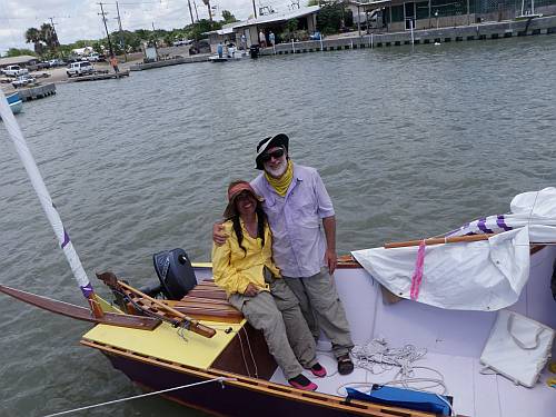

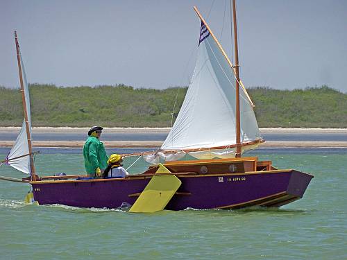

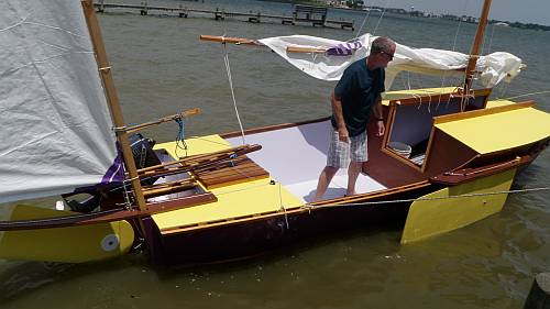

Update, 2012. John Goodman built the prototype. John is a very experienced builder and sailor which is a great thing for me. He found a few errors in the plans. The main flaw was in not allowing enough room between leeboard and hull with the result that the leeboard can at time bind against the widely flaring hull side. The simple fix was to make the leeboard guards wider. I fixed that on the drawings. There was another potential issue with the bevel given for the sides of the bow transom. John didn't agree with my number and supplied his own. I must admit I have rerun the space age rocket science vector analysis that I use to give the bevel and I keep getting the same wrong answer so I don't really know what to think. I have added John's bevel to the plans beside my own so you will have to assemble the parts enough to scope it out, never a bad idea anyway. There can be an explanation in this depending on where the bevel is measured.
John did the right thing and made his hull with the 18" stern extension. I should have drawn it that way in the first place. On the updated drawings I now show the layout for the added length to the side panel and the resulting transom pattern. But the extension does not appear in the side views, etc.
John took her out on a few short shakedown runs and then immediately into the Texas200 for which she was designed. He crewed for his wife Rosa. They camped in the boat at the stops. He reported no severe problems although he said she had stout weather helm until he rerigged the main further forward. Now, I drew the rig to balance well without the mizzen so this is not too much surprize, especially in the strong winds of the TX200 where the main is always reefed but the mizzen is not. To add to this I believe his mizzen is mounted on his new transom extension 18" aft of the original mizzen location which would add to the weather helm. But not to worry. These rigs are very easy to adjust and a quick and permanent fix, if needed, might be to adjust the rake of the mast by moving the mast partner, which simply bolts to the deck slot beam, forward as required. Anyway, that is how I look at it now. I would not be too quick to change it until I also sailed her in light winds since high winds almost always add to weather helm. Also, in the strong TX200 winds with the boat going hull speed all the time he found the sink weight in the rudder to be too small, with the result that the rudder would not hang vertically and instead would slant back a bit. That increases the helm forces which could be quite tiring given 40 mile legs of the TX200. So maybe the rudder could stand more lead, or maybe the sails adjusted to remove the helm force. Here are a few photos. You can see that the extra stern extension adds a lot to the boat.

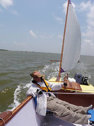

The line of fine bubbles following the boat in that photo means to me she was pretty much at or above hull speed, maybe planing. Also, note that the boat looks comfortable to the skipper, very important on the long stretches of the TX200. Someone sent this shot of the boat at that time and she is trying to rise up and plane. And note that the power of the coastal wind is such that you can get this speed in flat water with just a scrap of sail:
